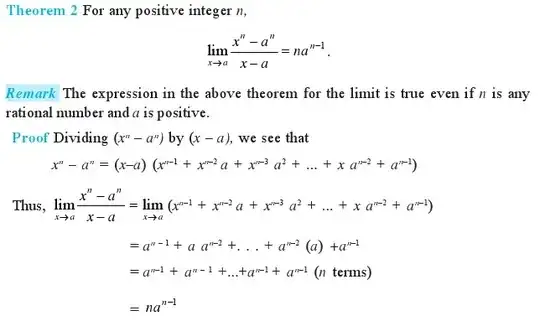

I am not getting how they factorised the $x^n-a^n$ term?
- 47,747
- 17
1What are you not getting? The factorization is right there, on the line below the blue "Proof". Do you deny that the product of the two factors is $x^n-a^n$? – hmakholm left over Monica Feb 19 '17 at 13:27
It is, but to be honest, that explanation only shows the check that the long division is correct. It doesn't really go into the division itself. – Daniel Goldman Feb 19 '17 at 13:34
This is a high-school identity. It is derived from the factorisation: $;1-x^n=(1-x)(1+x+x^2+\dots+x^{n-1})$ which is the basis for the sum of the geometric series, and is easily proved by induction. – Bernard Feb 19 '17 at 13:36
@Bernard There are other ways to derive it as well. – Feb 19 '17 at 13:36
1@A---B: The high-school identity is the simplest for me. I learnt it when at the end of mid-school. – Bernard Feb 19 '17 at 13:38
@Bernard This is my favorite identity I never miss a chance to use it. – Feb 19 '17 at 13:41
@Bernard You can write an answer to this question. – Feb 19 '17 at 13:42
Oh! I like the induction approach. – Daniel Goldman Feb 19 '17 at 13:43
Could you add your effort here? – S.C.B. Mar 12 '17 at 09:29
