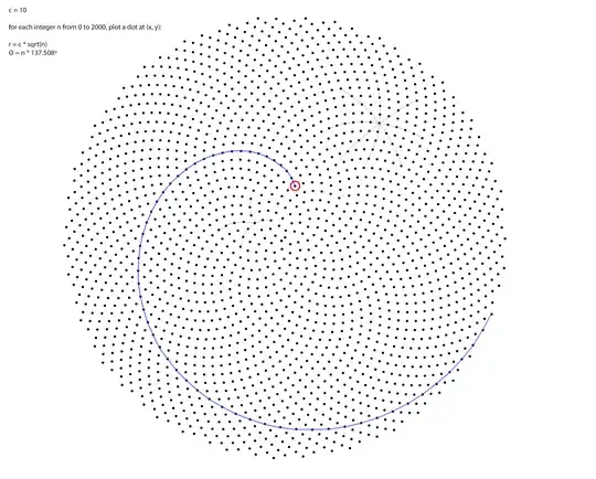

So I've been playing around with Fermat spirals recently, and I noticed that depending on how hard you look at one, each point has one or more "secondary spirals" coming off of it. Below is a link to a diagram I made illustrating this.
My question is: what's up with those? How can I get the dot indices or dot coordinates to draw these secondary spirals?
A diagram I made

  • I have learned that these secondary spirals are called "parastichies". – jabelsjabels Feb 19 '17 at 00:14
  • Without saying that it is the same thing, I see a certain similarity with the figures, especially the last one, given in a recent question of mine (http://math.stackexchange.com/q/2127476) – Jean Marie Feb 21 '17 at 21:08
  • Indeed with the keyword "parastichies", one can find very interesting sites for example, concerning "phyllotaxy" (another keyword):(http://www.science.smith.edu/phyllo/Applets/Spiral/Spiral.html#) – Jean Marie Feb 21 '17 at 22:09
Adding (or subtracting) a fibonacci sequence number to the index of any dot will move you one dot along a secondary spiral. In my case, the numbers that worked best are 21 and 34.
Thanks to a guy in ##mathematics on IRC for the suggestion :)
