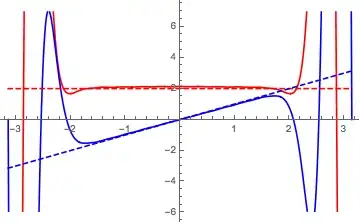

Machinato suggests that $f(z)=\sum_{n=2}^{\infty} \frac{(-1)^n z^{n-1}}{n! \log n}$ approaches $\log z$. This seems to be true! As evidence, here are plots of the real (red) and imaginary (blue) parts of $f(e^{2+i \theta})$, for $-\pi<\theta<\pi$. For comparison, the red and blue dashed lines are the real and imaginary parts of $\log z = 2+i \theta$. It's not clear from this image whether the limit holds for all $\theta$, but for $-\pi/2 < \theta < \pi/2$ the fit is very good.
I'm offering a bounty for a proof of this bizarre behavior. I imagine the precise formulation is that, for $\theta$ fixed in $(-\pi,\pi)$, we have $\lim_{R \to \infty} f(R e^{i \theta}) - \log R = i \theta$ but I'll certain accept other asymptotic results of a similar flavor. (For $\theta = \pi$, it is easy to see that $f(-R)$ grows faster than any power of $R$, so it can't mimic $\log R$.)

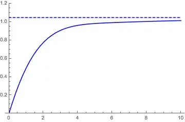

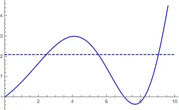

After some more experimentation, I suspect the limit only holds for $-\pi/2<\theta<\pi/2$. Here are plots of $\mathrm{Im}(f(r e^{i \theta}))$ for $\theta = \pi/3$ (first plot) and $2 \pi/3$ (second plot), with $0 < r < 10$. In each case, the dashed line is at $\theta$. Convergence looks great in the first one, terrible in the second.
