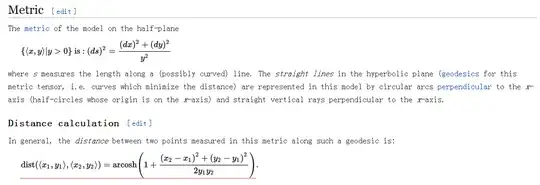

As in wiki,the distance function is
I don't know how to get this formula, I mean how to prove it.

    If forced to construct a clean proof from scratch off the top of my head, I'd use a Möbius transformation preserving the upper half-plane (i.e., a hyperbolic isometry) to send $p = (x_1, y_1)$ and $q = (x_2, y_2)$ to $(0, 1)$ and a point $(0, y)$ respectively, then perform the easy length integral along the vertical axis. – Andrew D. Hwang Feb 11 '17 at 13:47
