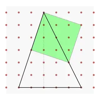

Not actually showing what you did wrong. S.C.B. did that. Just a nice graphical proof of your identity.
arctan 1, arctan 2, arctan 3
