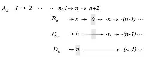

Here is the closest that I seem to get to the crux. Imagine a counting process $1 \rightarrow 2 \rightarrow 3 \rightarrow \dots n-1 \rightarrow n$ which we encode algebraically as $ x_{1}-x_{2}, x_{2}-x_{3}, \dots , x_{n-1}-x_{n} $. All of the classical Lie algebras share this set of simple roots. We can think of this as a signal propagating forward. The classical Lie algebras are distinguished by one additional simple root for which there are four allowed possibilities:
$ \begin{array}{1|2]3|4} A_{n} & n \rightarrow n+1 & x_{n}-x_{n+1} & = x_{n}-x_{n+1} \\ B_{n} & n \rightarrow 0 & x_{n}-0 & = x_{n} \\ C_{n} & n \rightarrow -n & x_{n}- -x_{n} & = 2x_{n} \\ D_{n} & n \rightarrow -(n-1) & x_{n}- -x_{n-1} & = x_{n-1}+x_{n} \\ \end{array} $
I interpret $A_{n}$ as the possibility that the sequence continues propagating forward. Otherwise the sequence is reflected backward. The sequence can take us first to an external mirror $0$ from which we would proceed to count backwards $-x_{n},-x_{n-1},\dots,-x_{1}$. Or the sequence can take us from $x_{n}$ directly to its reflection $-x_{n}$. Or it can turn out that $x_{n}$ is itself a mirror and so the counting proceeds $x_{n-1} \rightarrow x_{n} \rightarrow -x_{n-1}$ where we may think of $x_{n}$ and $-x_{n}$ as intrinsically indistinguishable conjugates.

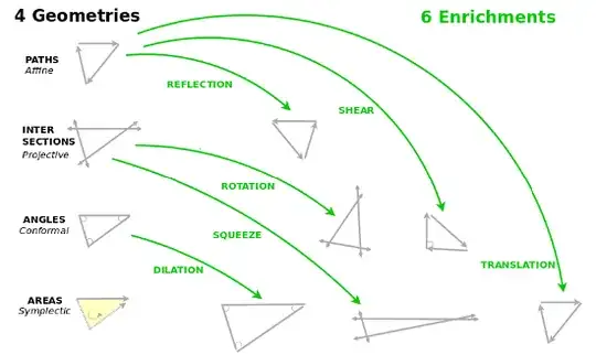

I would like to try to relate the Lie groups with four geometries: affine, projective, conformal and symplectic. And perhaps more basically, with four ways of thinking about a triangle:
  • The concatenation of three paths.
  • The intersections of three lines (on which we travel backwards and forwards).
  • Three angles that divide the triangle.
  • The oriented area of the triangle that we sweep out as we go around it.
I want to imagine that these get expressed as affine, projective, conformal and symplectic geometries, respectively. In my study of emotion and moods, I have found the different ways of thinking about a triangle to be useful in grounding six transformations which take us from a less specified geometry to a more specified one. I need to learn what gets preserved and how ($A_{n}$ - volume, $C_{n}$ - oriented surface area?, $B_{n}$ and $D_{n}$ - distance. I am thinking that complex derivatives (that is, holomorphic functions where the first derivative is nonzero) preserve angles and so $A_{n}$ expresses conformal geometry. And I am imagining that of $B_{n}$ and $D_{n}$, perhaps the first has an explicit origin and is thus the basis for projective geometry, whereas the second does not have an explicit origin and is the basis for affine geometry.

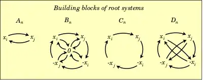

Finally, I am trying to think of the root systems as constructing infinite families of polytopes. Here it may be helpful to identify each eigenvalue with a vertex and each root with an edge of a polytope. We have the following kinds of building blocks:

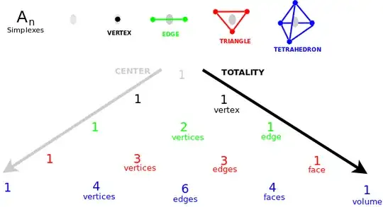

$A_{n}$ can be identified with the simplexes. I think of the simplex as having a unique center - the -1 simplex - which keeps moving as the simplex grows. Similarly, the simplex has a unique volume. The binomial expansion then codes for all of the subsimplexes.

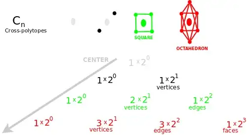

Now I think of the cross-polytopes as being generated by the center creating pairs of vertices, positive and negative, which are linked to all of the existing vertices but not to each other. This accords with the root system $C_{n}$. If we look at the triangle which counts the sub-polytopes, then we see that it has a unique center but the largest number counts the surface area, which is to say, there is no volume!

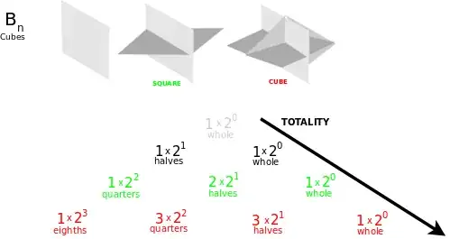

The duals of the cross-polytopes are the hypercubes, which can be thought of as generated by mirrors (hyperplanes). They have a volume but no center! I don't see how to relate $B_{n}$ with such a hypercube. Although perhaps the 0 is the total volume and it lets us construct our hypercube "top down" by dividing the whole volume rather than "bottom up" by assembling the vertices.
Finally, I expect there should be an infinite family of polytopes $D_{n}$ with no center and no volume. But I don't think it is the demihypercubes. I need to try to interpret the root system as a polytope.
