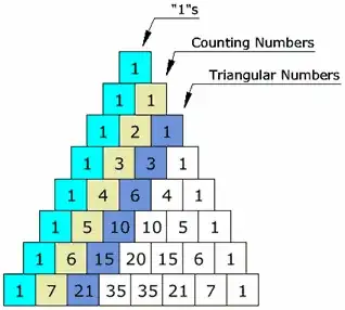

One can also try the hockey-stick identity:
$$\sum_{k=1}^nk=\sum_{k=1}^n\binom k1=\binom{n+1}2=\frac{n(n+1)}{2!}$$
(poor ones get a lame name) As you can see, each diagonal is the sum of the previous due to how Pascal's triangle is made.

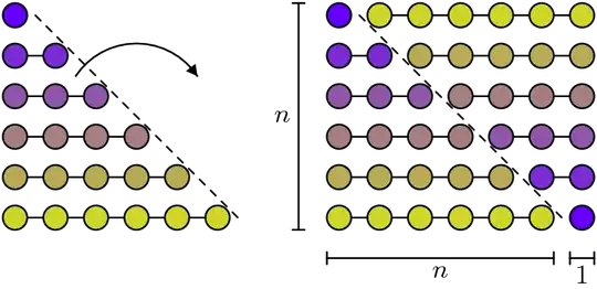

Consider $1+2+3+...n$. Add $1+2+3+...n$ to it. This counts the number of unit squares in an $n$ by $n$ square, but double counts $n$. So,
$$2(1+2+3+...n)=n^2+n$$
$$1+2+3+...n=\frac{n(n+1)}{2}$$
This figure aims to illustrate the argument.
Another way is by using area. Ignore the upper white area in the figure above. Then the area of the shape can be divided into an $n$ by $n$ right triangle and $n$, $1$ by $1$ right triangles so the total area is,
$$1+2+3+....n=\frac{n^2}{2}+n\frac{1(1)}{2}$$
$$=\frac{n(n+1)}{2}$$
This proof without words was entered and then deleted by @user170231, so I'm marking my answer community wiki. I don't think it counts as a duplicate of Gauss's proof.
