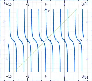

When the equation is written as $x=\cot x$, by graphing it is quite obvious that there is exactly one solution per interval $(k\pi,(k+1)\pi)$. This is easily confirmed by the fact that the derivative of $\cot x$ is everywhere negative, hence the function is strictly decreasing from $\infty$ to $-\infty$ between two vertical asymptotes.
The larger $x$, the closer the roots get to $k\pi$. If we write $x=k\pi+\delta$, we have $\cot x\approx1/\delta$ and
$$x_k\approx\frac{k\pi+\sqrt{k^2\pi^2+4}}2,$$ which is a good starting approximation.
