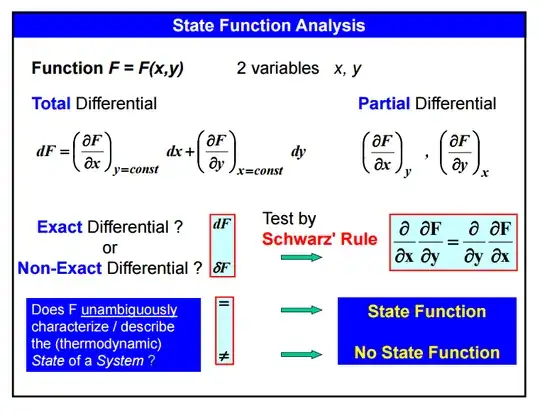

All this comes from a course I am taking in Thermal Physics.These are the two slides[![][1]]2

An explanation of Schwarz' Theorem in this context would be great too.

You might notice that the test using Schwarz' rule that your image is alluding to boils down to checking if a differential $\omega$ satisfies $\mathrm{d} \omega = 0$. These are also special:
A differential form $\omega$ is closed if and only if $\mathrm{d} \omega = 0$
It turns out that every exact differential form is closed, and conversely, in extremely nice spaces like $\mathbb{R}^n$, every closed differential form is exact.
Since testing if a form is closed is relatively easy and computational, it provides a very nice first step in checking whether a differential is exact — and in very nice spaces like $\mathbb{R}^n$ it's the only step you need!
