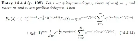

Ramanujan considers the function $$ F_w(t)=\int_{0}^{\infty}{\sin(\pi t x)\over\tanh(x\pi)}e^{-\pi wx^2}~\mathrm dx $$ and proves the following proposition enter image description here
where the prime $'$ on the summation sign indicates that the terms with $j = 0, n$ are to be multiplied by $\frac{1}{2}$.
This formula allows one to calculate $F_w(t)$ when $w=-\eta_2ni/(\eta_1 m)$, because in that case $s=t$ and 14.4.14 can be solved for $F_w(t)$.

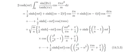

For example, for odd $m$ and $n$ 14.4.14 becomes:enter image description here
Now divide (14.5.3) by $t$ and take the limit $t\to 0$. Of course the integral will be divergent, however it is made convergent by substracting $4\int_{0}^{\infty}x\cos(\pi x^2)~dx=0$. For example for $m=n=1$ one gets $$ 4\int_{0}^{\infty}{x\cos(x^2\pi)\left(\frac{1}{\tanh(2x\pi)}-1\right)}~\mathrm dx=\frac{1}{2}+\frac{-1}{2}(-1)+\left(\frac{-1}{2}\cdot \frac{1}{\sqrt{2}}+\frac{1}{2}\frac{-1}{\sqrt{2}}\right)-0\\ =1-\frac{1}{\sqrt{2}}.\tag{**} $$
