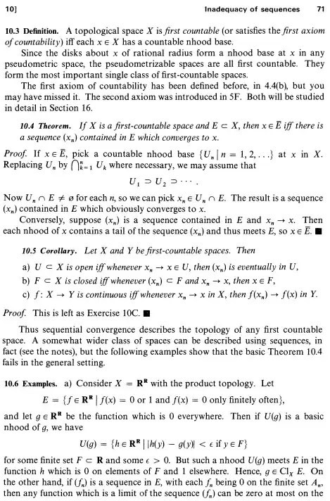

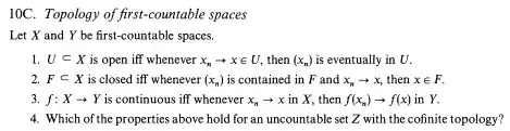

Edit (in response to the comments)

  • @DanielFischer Isn't the codomain important? The result that I found says that "if $X$ and $Y$ are first countable then any sequentially continuous map from $X$ to $Y$ is continuous". As $E'$ is not first countable (in the infinite dimensional case), I thought that this result couldn't be applied. Can we in general drop the first countability of $Y$? – Pedro Jan 15 '17 at 13:58
    The topology on the codomain is irrelevant. Let $X$ be first countable, and $Y$ a topological space. Suppose $f\colon X \to Y$ is not continuous at $x_0\in X$. Then there is a neighbourhood $W$ of $f(x_0)$ such that $f^{-1}(W)$ is not a neighbourhood of $x_0$. Choose a neighbourhood basis $U_1 \supset U_2 \supset \dotsc$ of $x_0$, and $x_k \in U_k \setminus f^{-1}(W)$. Then $x_k \to x_0$ (since the $U_k$ are a neighbourhood basis) and $f(x_k) \not\to f(x_0)$ (since $f(x_k) \notin W$), so $f$ is not sequentially continuous at $x_0$. – Daniel Fischer Jan 15 '17 at 14:06
  • @DanielFischer Thanks (is the Willard's book that assumes $Y$ first countable, Corollary 10.5). – Pedro Jan 15 '17 at 14:50
  • That's odd. I wouldn't expect that a book on topology includes unnecessary hypotheses in such a theorem. What exactly is the statement of the theorem in Willard's book? – Daniel Fischer Jan 15 '17 at 14:57
  • @DanielFischer See my edit. – Pedro Jan 15 '17 at 15:08
  • I have to repeat myself. That's odd. I see no reason why he assumed $Y$ first countable too. – Daniel Fischer Jan 15 '17 at 16:22
