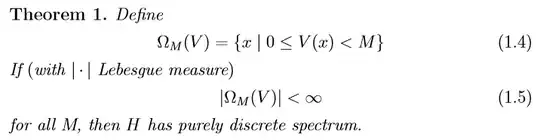

This is a nice result that holds in $\mathbb{R}^n$ for $n\ge 1$ and strikes a nice balance between generality and applicability. The potential $V$ is real, and $H=-\Delta + V$. The requirement on $V$ is that there is finite area in the given region (or finite volume in $\mathbb{R}^n$ for $n > 1$.)

@s.harp : That's the paper. Thanks for posting a link. I couldn't find one. – Disintegrating By Parts Jan 12 '17 at 16:10
@TrialAndError it was you that showed me that paper in this question :) – s.harp Jan 12 '17 at 16:44
