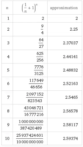

Here is a table of the sequence $\left(1 + \frac{1}{n}\right)^n$ from Wolfram Alpha:
table
You can see the sequence starts at $2$ and increases. So its limit cannot be $1$.
