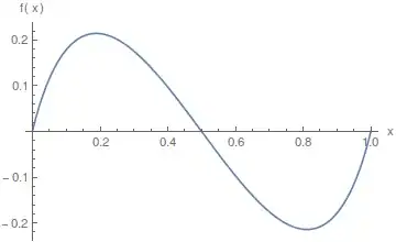

Let's denote the integrand by $f$: $$f(x)=x^x(1-x)^{1-x}(1-2x)\sin(x\pi).$$
The function $f$ appears to have a punctual symmetry: \begin{align}f(1-x)&=(1-x)^{1-x}(1-(1-x))^{1-(1-x)}(1-2(1-x))\sin((1-x)\pi)\\ &=-x^x (1-x)^{1-x}\sin(\pi x) & \\ &= -f(x)\end{align} so the point $(1/2,0)$ is a point of symmetry of the graph of $f$, hence the integral over $[0,1]$ (where $f$ is defined) is $0$.
The punctual symmetry can be guess from the graph of $f$ represented below:
Note that the equality also holds for integral boundaries in $[0,1]$ and centered around $1/2$.
