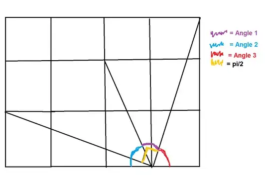

I know this is easy to lots of you but I am just struggling to find the solution. How can I prove the sum of the highlighted angles in the following 3 times 3 square grid is equal to $\pi$?

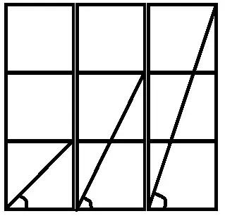

Hint: Apply the arctan addition formula to angles $\arctan(1), \arctan(2), \arctan(3)$.

The first angle is $\pi /4$ because his tangent is equal to $1$ so we must show that $a+b=3\pi /4$. Looking to the picture we have $\tan a= 2$ and $\tan b= 3$ so:
$$\tan(a+b)=\frac{\tan a + \tan b}{1-\tan a \tan b}=\frac{2+3}{1-2\cdot3}=-1$$
and once $a+b \le \pi$ then $a+b=3\pi /4$.
