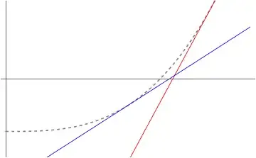

Let $f : [0, \infty) \to \Bbb{R}$ be defined by $f(x) = x^p - \alpha$ and suppose that we want to approximate the zero (which is of course $\sqrt[p]{\alpha}$ of $f$. Because we have no good numerical guess on $\sqrt[p]{\alpha}$, we pick an arbitrary guess $x_0 \in (0, 1)$. If we pretend that $f$ is linear, which amounts to replacing $f$ by the tangent line $y = f(x_0) + f'(x_0)(x - x_0)$, the true zero $x_1$ will be given by
$$ x_1 = x_0 - \frac{f(x_0)}{f'(x_0)} = \frac{p-1}{p}x_0 + \frac{\alpha}{p}x_0^{-p+1} . \tag{*}$$
Of course, $f$ is in general not linear and thus $x_1$ need not be $\sqrt[p]{\alpha}$. Since the tangent line approximates $f$ quite well near $x_0$, however, we can still hope that $x_1$ serves as a better guess for $\sqrt[p]{\alpha}$. Then we may repeat this procedure to improve our guess. Newton's method formalizes this idea.
Returning to our problem, we now have a geometric interpretation of $(x_n)$. Notice that $f(x) = x^p - \alpha$ is convex and strictly increasing on $[0, \infty)$ since $p \geq 1$. From this, any tangent line should lie below the graph of $f$. A moment of thought shows that the improved guess $\text{(*)}$ for $\sqrt[p]{\alpha}$ is always greater than or equal to $\sqrt[p]{\alpha}$; see:
In particular, if $x_n > \sqrt[p]{\alpha}$ (which corresponds to the red tangent line above) then $x_{n+1}$ decreases. On the other hand, if $x_n \in (0, \sqrt[p]{\alpha})$ (which corresponds to the blue tangent line above), it follows that $x_{n+1} > \sqrt[p]{\alpha}$. So possibly except for the first term, the sequence $(x_n)$ is always $\geq \sqrt[p]{\alpha}$ and decreases.
