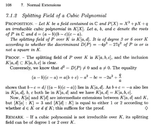

The discriminant (Wikipedia) of the polynomial $p(x)=x^3-3x+1\in\mathbb{Q}[x]$ is equal to $81$, which is a square in the field $\mathbb{Q}$. Letting $L$ be the splitting field of $p(x)$ over $\mathbb{Q}$, there is a theorem that since the discriminant is a square, we have $[L:\mathbb{Q}]=3$. Since $\mathbb{Q}(a)\subseteq L$ and $[\mathbb{Q}(a):\mathbb{Q}]=3$ also, we must have $L=\mathbb{Q}(a)$, i.e. the field $\mathbb{Q}(a)$ is the splitting field of the polynomial over $\mathbb{Q}$. Therefore it is normal over $\mathbb{Q}$.
(from Galois Theory by Jean-Pierre Escofier)
