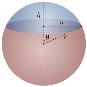

I need to be able to choose random points on a spherical cap surface for which the radius and centre of the actual sphere are known.
I'd like to do so by simply restricting the range of possible spherical coordinates (rho,theta, phi as shown on http://mathinsight.org/spherical_coordinates) of points on the cap.
How can I calculate the ranges over which theta and phi can vary for points on the cap, if the cap is specified by the centre of its base and the angle from its normal vector to its base (as depicted on https://en.wikipedia.org/wiki/Spherical_cap)?

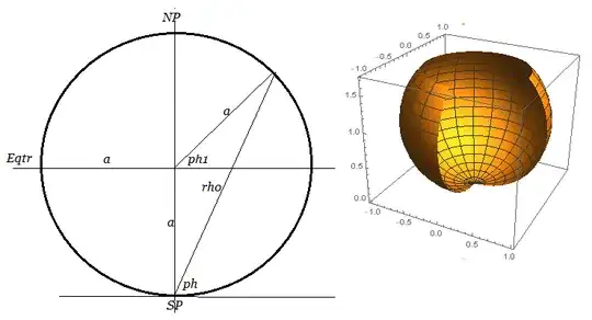

HINT:
To find how $\rho, \phi$ get modified, consider trig of triangle including sphere center, south pole and required point.
Angle subtended at center is double angle at south pole. $$ \pi/2- ph1 = 2 (\pi/2- ph)$$ $$ ph= \pi/4+ ph1/2$$
$$ \rho^2 =a^2+a^2 -2a\cdot a \cos ( \pi/2 +ph1)$$ $$ \rho= 2 a \sin ( \pi/4 + ph1/2)$$
Note $ \phi, \theta$ limits I chose in reckoning spherical cap coordinates from south pole:
a = 1; ParametricPlot3D[
 2 a Sin[Pi/4 + ph1/2]*{Cos[(Pi/4 + ph1/2)] Cos[t],
   Cos[(Pi/4 + ph1/2)] Sin[t], Sin[(Pi/4 + ph1/2)]}, {t, 0,
  3 Pi/2}, {ph1, -Pi/2, Pi/4}]
