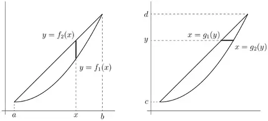

Disclaimer: This answer invokes infinitesimals in a squishy, pragmatic way. The results are correct, but justifying their correctness requires work beyond the scope of this question.
The fundamental idiom of integral calculus (a name I'm trying to popularize) states:
To calculate a total quantity (area, length, volume, work...), split the quantity into infinitesimal increments that can be computed using algebra, then add them up (i.e., integrate) to find the total.
Suppose we wish to calculate the area of the plane region $R$ bounded below and above by the graphs $y = f_{1}(x)$ and $y = f_{2}(x)$, and bounded to the left and right by the vertical lines $x = a$, $x = b$. More succintly, $R$ is the set of $(x, y)$ with $$ f_{1}(x) \leq y \leq f_{2}(x),\qquad a \leq x \leq b. $$
To apply the fundamental idiom, we slice $R$ into "thin vertical strips": For each $x$ between $a$ and $b$, we have $f_{1}(x) \leq y \leq f_{2}(x)$. The portion of $R$ "at $x$" (or, if you prefer, "between $x$ and $x + dx$") is a rectangle of height $f_{2}(x) - f_{1}(x)$ and width $dx$, and so has area $$ dA = (f_{2}(x) - f_{1}(x))\, dx. $$ The total area of $R$ is the sum (i.e., integral) of these increments: $$ \text{area} = \int_{a}^{b} (f_{2}(x) - f_{1}(x))\, dx. $$
Area of a plane region sliced into vertical or horizontal strips
Entirely similar ideas work if our region $R$ can be sliced easily into horizontal strips, i.e., if $R$ can be conveniently defined by inequalities $$ g_{1}(y) \leq x \leq g_{2}(y),\qquad c \leq y \leq d. $$ In this event, $$ \text{area} = \int_{c}^{d} (g_{2}(y) - g_{1}(y))\, dy. $$
As for sketching in practice: Draw the specified curves separately, then determine (by inspection or calculation) where they intersect. If necessary, decide whether to calculate the area by slicing the region into vertical or horizontal strips, and express the region accordingly using graphs of functions. The points of intersection give the limits of integration.
In more complicated examples, it may be necessary to split the region into sub-regions, and to use the preceding paragraph separately on each piece. (Commonly, for example, one wants the region between two graphs that cross in the interior of the interval of integration.)
In your specific example, you have the line $x = 4y - 2$ (which can be sketched by finding two points on the line), and the parabola $x^{2} = 4y$, which opens to the right, is symmetric across the $x$-axis, and passes through the origin and the point $(2, 1)$.
Since each curve is given in the form of $x$ as a function of $y$, horizontal slices are easiest. Your sketch will tell you
  • Which curve is the left edge, $x = g_{1}(y)$, and which is the right edge, $x = g_{2}(y)$;
  • What the limits of integration, $c \leq y \leq d$, are.

  • The two curves specify the endpoints of a thin rectangular slice; the relevant dimension of the slice is the difference: top minus bottom, or right minus left. Do the accompanying diagrams not help? – Andrew D. Hwang Dec 29 '16 at 18:00
  • No its not helpful. –  Dec 30 '16 at 05:20
  • Is there a particular part of the argument you don't understand? In itemized form, the argument boils down to: 1. If a region is cut into thin strips, the total area of the region is equal to the sum of the areas of the strips. 2. Each strip is (approximately, but nearly enough so that the conclusion is correct) a rectangle, with one side very small. 3. The distance between two points on a number line is the larger minus the smaller. – Andrew D. Hwang Dec 30 '16 at 12:55
