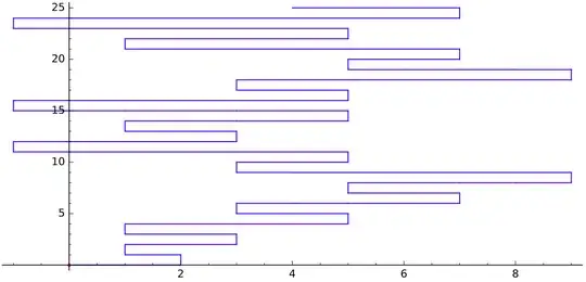

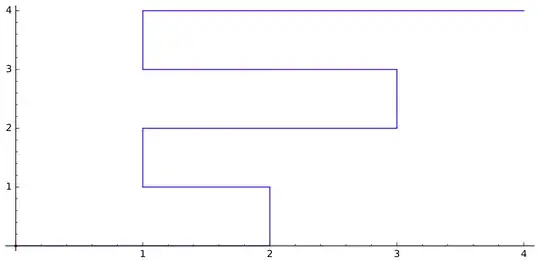

To illustrate the rules, a drawing will perhaps be more explicit:
$$\begin{matrix} & 7 & 8 & 9 & 10\\ & 7 & 6 & 5 \\ & 3 & 4 & 5 \\ & 3 & 2 & \\ 0&1&2& & \end{matrix}$$
Or with blue lines:

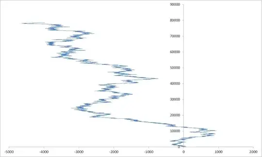

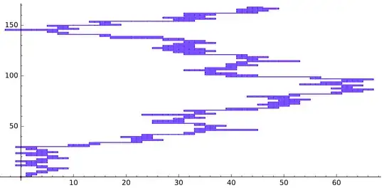

Well now nothing stops us from going a little further, which we will do until $n=100$, and then until $n=1\,000$.
It seems that the walk is almost always on the right side of the $y$-axis. Though the walk is crossing the axis a few times.

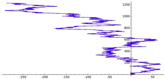

Let us walk until $n=10\,000$.
Then we realise that we have completely changing the side of the axis we were walking on.

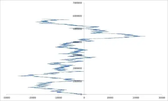

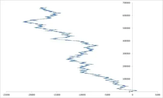

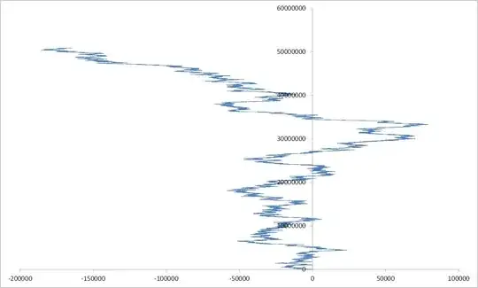

Some more graphs:
Up to $n=100000 = 10^5$:
Up to $n=1000000 = 10^6$:
Up to $n=10000000 = 10^7$:
Up to $n=100000000 = 10^8$:
And finally, up to $n=1000000000 = 10^9$:

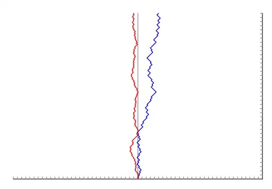

This Applies to Prime Gaps.
In this case, the Prime Gaps are just a random walk which changes direction at a Prime.
Below is a diagram showing how the Prime Walk (Blue) and Random Walk (Red) compare for values up to $y=500$. Prime Walk vs Random Walk
Even though the Prime walk is strongly biased towards smaller numbers, there is no known maximum distance between prime gaps which means there is a chance, albeit an even smaller than normal, yet a non-zero chance that the next prime is far enough away to $x\le0$.
