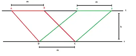

enter image description here In the geometric construction above we have the line $t$ parallel to $s$. Those two paralelogram are just examples about what is happening. For any choice of $AB$ we will always have $AD=BC$ and $DC=DC$ and once $s$ and $t$ are parallels then the height $h$ is constant. It means that we will always have:
$$ar(ADC)=ar(BCD)=\frac{m\cdot h}{2}$$
and clearly there are infinite angles $\angle ADC$ that are not $90º$ and the parallelogram will not be a rectangle. Furthermore if $\angle ADC \ne 90º$ then $\angle ADC \ne \angle BCD$ and once the rule (side,angle,side) can be the definition of congruence between two triangles we will get $BD \ne AC$.

    Thank you @Lone. I was thinking about a more geometric explanation and I realized that maybe a picture would help people understand what I was trying to say. That's why the EDIT. – Arnaldo Dec 24 '16 at 14:30

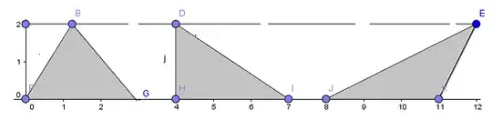

Area of a triangle is
$$ Area = \frac12 b\, c \sin A $$
Among the three, two parameter values excepting $A$ are given, then the remaining angle $A$ and its supplement can satisfy this relation.
If you take base $b$ and $ h= c \sin A $ as height all the following shaded areas have same magnitude:
When area and height remain same (red line is height) $\sin A $ is same. Taking inverse of sine we can have two solutions $\alpha,\beta$ which are supplementary :

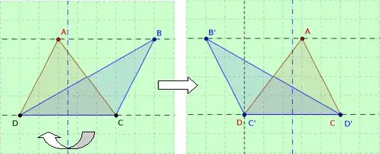

The answer by Narasimham is fully right.
To visualize it better, consider to flip $\triangle BCD$ around the bisector of the common segment $DC$.
Quadr_Tr_t
The resulting sketch shows that angles in $D$ (for $\triangle ADC$) and $C$ (for $\triangle BCD$) are supplementary. They are equal only when they are rect, i.e. when the quadrilateral is a rectangle.
