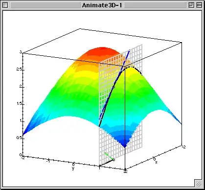

As always, a picture is worth a thousand words: if you can glean the meaning of the directional derivative from this .gif I found online then you may not need to read what I have to say. I hope the animation helps either way.
A gif I found online.
It's worth noting that the little green segment at the base of the figure in this animation is meant to represent the value of the gradient of the function at the given point.
