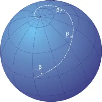

But what about a Loxodromic curve? A loxodromic curve, or rhumb line, is defined as arc that crosses all meridians of longitude at the same angle (rhumb).
rhumb-line-wikipedia
I'm thinking hard to get the condition A and B have to meet so that there is only ONE loxodromic between them. Any hints that would lead me to the correct path will be more than welcome.
