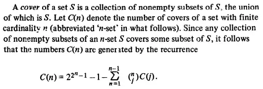

The problem is equivalent to count the number of covers of a finite set.
It is mentioned at the beginning of the paper Minimal Covers of Finite Sets by Hearne and Wagner that the number is given as the following (where "$n=1$" should be a typo):
Alternatively, the number of possible covers for a set of $N$ elements are
$$ C(N)=\frac{1}{2}\sum_{k=0}^N(-1)^k\binom{N}{k}2^{2^{N-k}}, $$ the first few of which are $1, 5, 109, 32297,\cdots$ (OEIS A003465: Number of ways to cover an n-set. ).
  • Yes thank you. I agree. I see now that the equation above counts the covers using the principle of inclusion exclusion. Here I want to include the empty set in the families (covers). So I will ignore the factor of 1/2 in the equation to find A000371. Then the number of families whose union does not equal the whole set is 2^2^n - A000371 = A005530 as stated above by Alex Kruckman. – Geoffrey Critzer Dec 18 '16 at 22:36
