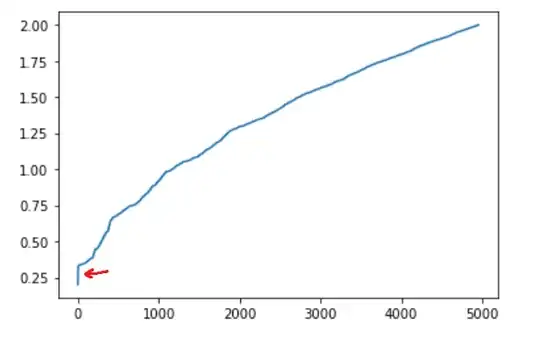

The minimum distance between each pair of points isn't actually taken on as many times as we would expect. However, if we were to plot these values, we can see that there is a significant jump at the start, meaning that only a few points are actually "somewhat close" to each other:

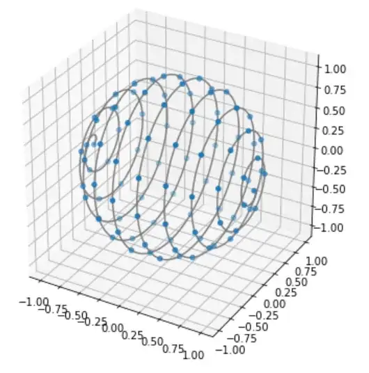

While this method is hard to reproduce in higher dimensions, I have found a different method with similarly good results, which I call the "spiral method". The idea is to map a straight line onto the surface of the sphere in a spiral method, then place equidistant points on the line:

It's not significantly worse than the Fibonacci method, I'd say. Plotting these values gives:
There is a slightly shorter vertical section at the start, but importantly, the minimum distance between points is the exact same value, about $0.201$.

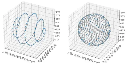

where $c$ is a proportionality factor, namely the optimal $c$ in $3$ dimensions is
$$c = \pi$$
If we choose $c$ to be smaller, then there would be fewer revolutions around the sphere, and if $c$ was larger, then there would be more revolutions. In the following example, I set $c$ to be $\frac{\pi}{2}$ on the left, and $2\pi$ on the right. In both caes, there will be some points that are "too close" to each other:

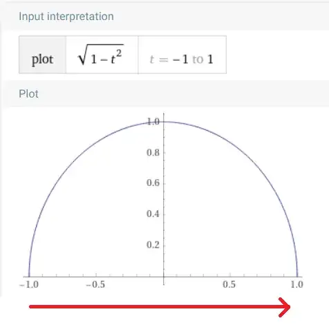

"$\sqrt{1-t^2}$ rule": Move the spiral along the new direction with the rate of $\sqrt{1-t^2}, t \in [-1,1]$.
This will clearly move the spiral homogeneously along the new direction, since the parametrization of the upper half of the circle in the new direction is $\sqrt{1-t^2}, t \in [-1,1]$. For those that are more visual, this is the "speed" at which we move the spiral with towards the new direction:
As you can see, this exactly describes the upper half of a circle.
However, $t$ isn't simply a linear factor in our case, it's instead the distance between the $z$ axis and each point of the spiral, namely
