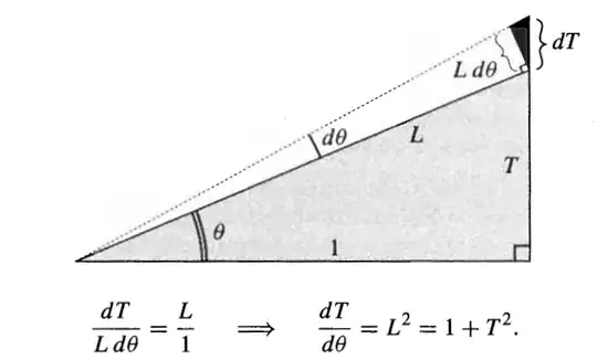

I started to flick through Needham's Visual Complex Analysis and pretty much fell on my face in the first exercise.
On page ix, he shows a proof that $dT/d\Theta = 1 + T^2$ if $T = tan(\Theta)$.
He does so by comparing the black triangle with the initial triangle (grey). What I don't understand is why the length of the one segment is $L*d\Theta$. I'm sure I'm lacking some basic math here.....
Shouldn't the length be $L*tan(d\Theta)$ (which obviously would be less helpful)?
Needham - Visual Complex Analysis; triangle to proof the above formula

Since $d\theta $ is small, he is approximating the side of the triangle with the length of the curve which is $L d\theta$ when $\theta$ is in radians.

  • @DonAntonio that which is of length $L d\theta $ i.e. a circular arc? – RSS Dec 17 '16 at 21:08
  • Thanks. Perhaps that it so. I can't though see why would they (or Newton) do such an assumption without explaining it... – DonAntonio Dec 17 '16 at 21:21
  • How big is the error when comparing the arc to the segment? As an engineer I'm fine with this as an estimate, just curious if this is an exact assumption and if not if the reasoning for it is going beyond "good enough" (not that there is anything wrong with that....) – pandita Dec 17 '16 at 23:43
  • @pandita the error is exactly as big as the residual terms in the Taylor series expansion. This is just the geometric version of that argument. You can calculate the error to arbitrary precision. – RSS Dec 18 '16 at 00:40
Remember the Taylor Series for $\tan(x)$ about $0$! You find that $\tan x \sim x$ cutting off the series to the most significant term. Otherwise, you are completely right that it should be $L \tan(d\Theta) $ by basic trigonometry... Now apply the Taylor Series.

In the event you want to prove the first term of the Taylor Expansion geometrically, use the well known, geometric proofs of $\sin x \sim x$ and $1-\cos x \sim 0 \implies \cos x \sim 1$ by drawing triangles and comparing chord and arc lengths, noting that $\tan x = \frac{\sin x}{\cos x} $
