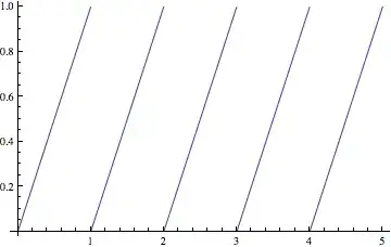

Here is a plot of the fractional part of $x$:
Plot of fractional part of x
Notice how it's discontinuous when $x$ is an integer, and continuous everywhere else. To prove this formally, notice that on $[n, n + 1) : n \in \mathbb{N}$, this function is equal to $x - n$. Only at integer values does this function make a jump.
$(nx)$ is only slightly different from $(x)$. Instead of being discontinuous at integers $\mathbb{Z}$. It's discontinuous at $\frac{1}{n}\mathbb{Z}$.
For a fixed $n$ and bounded interval, $f_n = \dfrac{(nx)}{n^2}$ has a finite number of such discontinuities. Thus, it's Riemann integrable. It follows that the uniform limit of $\displaystyle \sum_{n=1}^\infty f_n$ is also Riemann integrable on a bounded interval.
