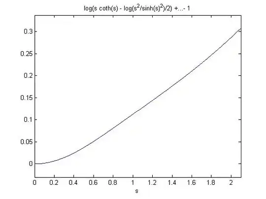

For the left bound we need to establish $f = p - 1 + \ln(m) > 0$. Since $p>0$ anyway, this needs only be considered for $1\leq m < $e . Since at $s= 2.1$, $m(s) >$e, we consider the range $0\leq s<2.1$
Inserting $p$ and $m$ gives
$$ f(s) = \dfrac{s^2}{(\sinh(s))^2} - 1 + \ln(- \ln(s) + \ln(\sinh(s)) + s \coth(s)) $$
This looks as follows: enter image description here
Further, near $s=0$, by expansion, $f \simeq s^2/6 \geq 0$. This establishes the left inequality.

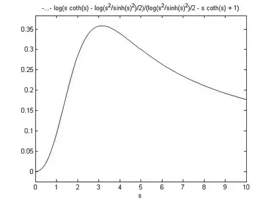

For the right inequality, we need to establish $g = \frac{ \ln(m) }{m-1} - p> 0$. Inserting $p$ and $m$ gives
$$ g(s) = - \dfrac{s^2}{(\sinh(s))^2} + \frac{\ln(- \ln(s) + \ln(\sinh(s)) + s \coth(s))}{- \ln(s) + \ln(\sinh(s)) + s \coth(s) - 1} $$
Near $s=0$, by expansion, $g \simeq s^2/12 \geq 0$.
The overall behaviour looks as follows: enter image description here
For larger $s$, we have that $g(s)$ decreases monotonically with the limit $g(s\to \infty) = 0$.
This establishes the right inequality.
