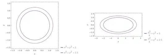

The reason why $\frac{dA}{dr}=C$ works for the circle is that (loosely speaking) increasing the radius by $dr$ adds a "stripe" of constant "width" around the circle, therefore the added area is (at the limit) proportional to $dr$. This does not happen for an ellipse, however, where the "stripe" becomes thicker around the endpoints of the longer axis, as can be seen in the drawings below.
dA/dr
