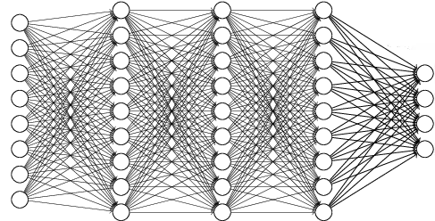

Is there a common name for the type of directed acyclic graph structure used in fully-connected neural networks?
E.g.
To be specific, I'm speaking of a directed graph, $G=(V,E)$, whose vertices can be partitioned into $k$ non-empty disjoint sets $V_1, ..., V_k$ such that $V = \displaystyle\bigcup_{i=1}^k V_i$ and $E = \displaystyle\bigcup_{i=1}^{k-1} V_i\times V_{i+1}$.
