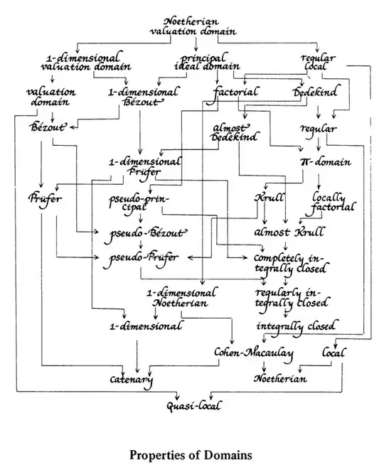

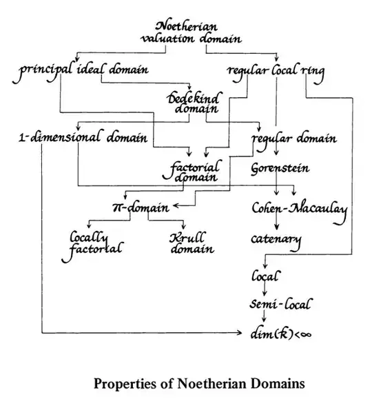

Hint $\ $ See the graphs below, from Hutchins' book Examples of Commutative Rings. You may find it an illuminating exercise to prove that those are the only arrows from/to local domains (many interesting (counter)examples are given in the book, which is based upon Hutchins' $1978$ Chicago thesis under Kaplansky).
