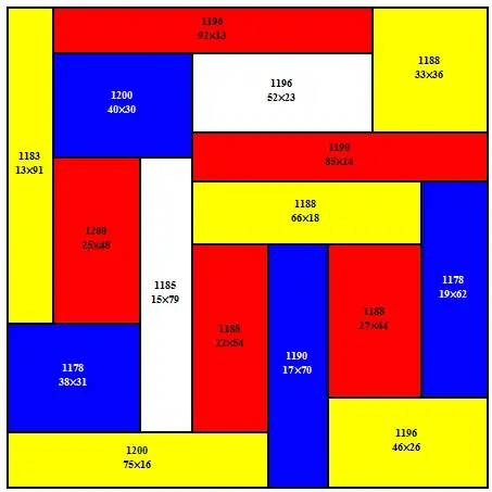

This is known as the Mondrian Art Problem. For example, here's a division for a square of size $n=138$. The largest area is 1200, the smallest 1178, with a difference of 22.
square 138

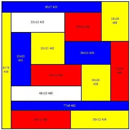

The last "hole" in the first 96 squares was for the following, with best known value a(78)=0 $((\left \lceil{\frac {78}{\log(78)}}\right \rceil +3)-(390-369) = 0)$.
Mondrian 78

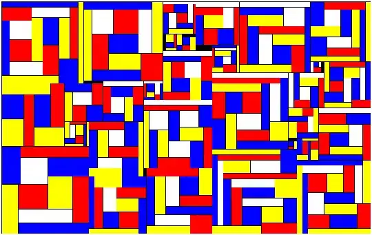

For eye candy, here are optimal rectangle dissections for squares 3 to 32 optimally packed into a rectangle (method):
Mondrian3-32

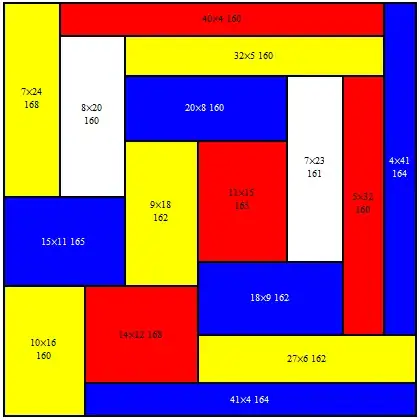

Here's the best known division of the size 51 square, into rectangles of area 160 to 168, for a defect of 8 (168-160). $\left \lceil{\frac {51}{\log(51)}}\right \rceil=13$, so this division has a quality of 5 (13-8).
Mondrian Variant 51
