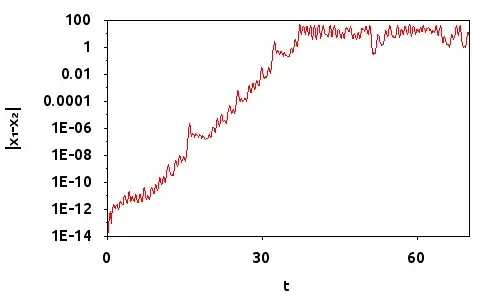

Once the separation of trajectories becomes too large, it is not exponentially growing but governed by the large-scale dynamics of the system. It then has some value that is of the order of magnitude of the size of the attractor (or invariant set) of your dynamics. E.g., here is the temporal evolution of two trajectories of the Lorenz system (attractor diameter $\approx 30$) starting off close by:
Now, you can see, that once the separation has reached the order of the magnitude of the attractor, it occasionally shrinks again (growing roughly exponentially afterwards). So the trajectories can come close to each other again. This happens along a direction corresponding to a negative Lyapunov exponent. This direction is orthogonal to the direction of largest separation which causes the positive Lyapunov exponents. This shrinking can be arbitrarily small and is the backbone of the topological transitivity.
