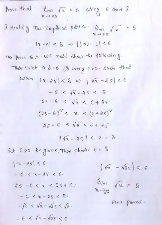

Prove that $\lim\limits_{x\to 25} \sqrt x = 5$ using $\epsilon$ and $\delta$.
can someone check my work please?
$$|x-a|<\delta \qquad\Rightarrow\qquad |f(x)-L|<\varepsilon$$ To prove this we must show the following:
There exists a $\delta>0$ for every $\varepsilon>0$ such that $$|x-25|<\delta \qquad\Rightarrow\qquad |\sqrt x-25|<\varepsilon.$$ \begin{gather*} -\varepsilon < \sqrt x - 25 < \varepsilon \\ 25-\varepsilon < \sqrt x < \varepsilon+25 \\ (25-\varepsilon)^2 < x < (\varepsilon+25)^2 \\ 25-\varepsilon < \sqrt x < \varepsilon+25 \\ |\sqrt x-25| < \varepsilon=\delta \end{gather*} Let $\varepsilon>0$ be given. Then choose $\varepsilon=\delta$. \begin{gather*} -\varepsilon < x-25 < \varepsilon \\ 25-\varepsilon < x < 25+\varepsilon \\ -\varepsilon < x-25 < \varepsilon \\ -\sqrt\varepsilon < \sqrt{x}-\sqrt{25} < \sqrt\varepsilon \\ -\varepsilon < \sqrt{x}-\sqrt{25} < \varepsilon \\ |\sqrt{x}-\sqrt{25}|<\varepsilon \\ \lim_{x\to25} \sqrt x = 5 \end{gather*} Hence proved.
  • You wrote 25 when you should have written 5 and then .... well I don't know what you did ... but $\sqrt {25 - e} \ne \sqrt {25} - \sqrt{e} \ne 5 - e$. You almost had it but it's more subtle. – fleablood Nov 28 '16 at 19:24
  • For some basic information about writing math at this site see e.g. here, here, here and here. – Martin Sleziak Dec 01 '16 at 16:50
  • You can find several similar questions on this site. For example: http://math.stackexchange.com/questions/310611 http://math.stackexchange.com/questions/450410 http://math.stackexchange.com/questions/1576670 – Martin Sleziak Dec 01 '16 at 16:52
Though your development is unclear (and there are typos), the answer is correct.

There rae lot of errors in your work.
For all $x$ such that $|x-25| < 9$ we have $16 < x < 34 $ then $4< \sqrt x$ then $9 < \sqrt x + 5$ and $\frac{1}{\sqrt x + 5} < \frac 19$
$|\sqrt x- 5|=\frac{|x-25|}{\sqrt x+5} \leq \frac19|x-25|$
For all $\varepsilon > 0$, let $\delta=\min(9,9\varepsilon)$
It's easy to show that $$\forall x \in \Bbb R,\quad |x-25| < \delta \Rightarrow |\sqrt x - 5| < \varepsilon$$
Mohamed
  • 3,771
You seem to have assumed $\sqrt{a + b} = \sqrt a + \sqrt b$ which is of course not true.
