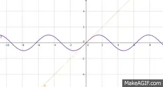

If you would like a bit of a visual intuition as to why $$\lim_{x \to 0} {\sin x \over x}= 1$$
here is a jank gif I made to show it. I believe one of the other answers discusses this analytically but notice how when you zoom in enough at 0, the graphs of $\sin x$ and $x$ effectively become the same? This is why the ratio of their limits as they approach $0$ goes to $1$.
