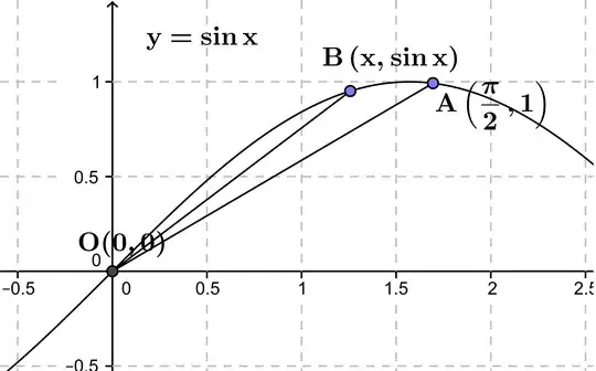

Let we have to prove $$t<\sin \left(\frac{\pi t}{2}\right)\;\forall t \in (0,1)$$
Now put $\displaystyle \frac{\pi t}{2} = x\Rightarrow t = \frac{2x}{\pi}$
So we have to prove $$\frac{2x}{\pi}<\sin x\;\forall x \in \left(0,\frac{\pi}{2}\right)$$
Now Slope of $$\displaystyle \bf{OB} = m_{0B} = \frac{\sin x-0}{x-0} = \frac{\sin x}{x}.$$
and Slope of $$\displaystyle \bf{OA} = m_{0A} = \frac{1-0}{\frac{\pi}{2}-0} = \frac{2}{\pi}.$$
So Here in above graph $$\displaystyle \bf{m_{OB}>m_{OA}}$$
So we get $$\displaystyle \frac{\sin x}{x}>\frac{2}{\pi}\Rightarrow \frac{2x}{\pi}<\sin x\;\forall x\in \left(0,\frac{\pi}{2}\right)$$
juantheron
  • 56,203
  • Nice! And special thanks for the picture! So basically, the solution boils down to the fact that the graph of $y=\sin x$ is concave down on $(0,\pi)$, so the graph lies above any secant line (within this interval). – zipirovich Nov 25 '16 at 06:11
