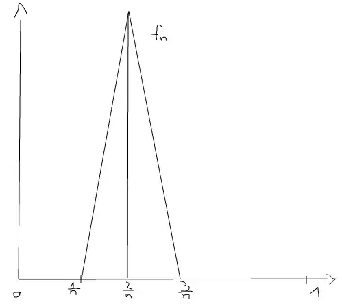

5.Define $$ f_n(x) = \begin{cases} n^2 x - n & x \in [\frac{1}{n}, \frac{2}{n}] \\  - n^2 x + 3n & x \in [\frac{2}{n}, \frac{3}{n}] \\ \end{cases}$$ for $n \geq 3$. This looks like this: enter image description here
(drawn using slimber)
