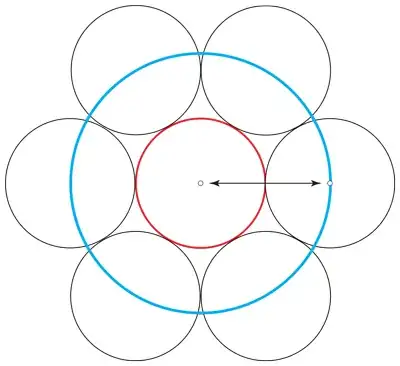

In general, I believe you are seeking the kissing number. In $d=2$, $6$ circles can touch a central $7$th, so $7$ points at pairwise distance $\ge r$ can be packed:
Kissing2D
In $d=3$, the kissing number is $12$, so you could surround one sphere with $12$, leading to $13$ (not $12$ as you say) points in the sphere each pair separated by at least $r$.

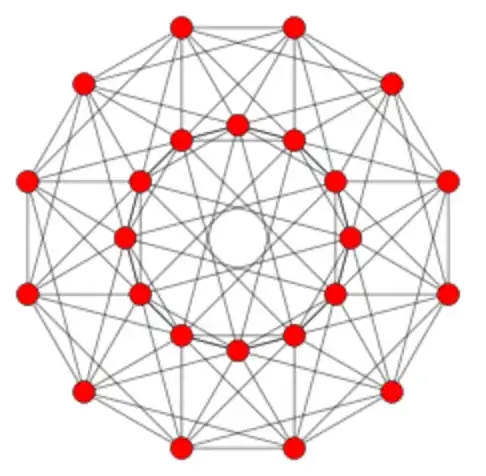

In dimension $d=4$, you would place the sphere centers at the vertices of the $24$-cell, and a $25$-th sphere in the center.
