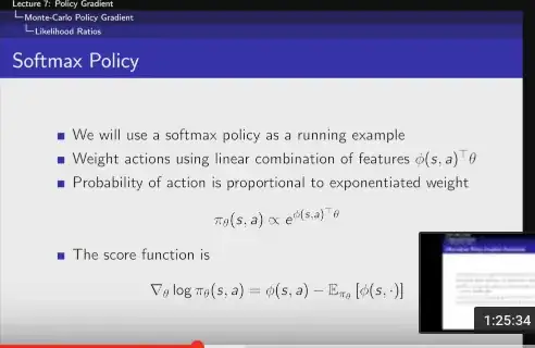

Could someone explain how that derivative was arrived at.
According to me, the derivative of $\log(\text{softmax})$ is
$$ \nabla\log(\text{softmax}) = \begin{cases} 1-\text{softmax}, & \text{if $i=j$} \\ -\text{softmax}, & \text{if $i \neq j$} \end{cases} $$ Where did that expectation come from? $\phi(s,a)$ is a vector, $\theta$ is also a vector. $\pi(s,a)$ denotes the probability of taking action a in state s.

The derivation of the softmax score function (aka eligibility vector) is as follows:
First, note that: $$\pi_\theta(s,a) = softmax = \frac{e^{\phi(s,a)^\intercal\theta}}{\sum_{k=1}^Ne^{\phi(s,a_k)^\intercal\theta}}$$
The important bit here is that the slide only identifies the proportionality, not the full softmax function which requires the normalization factor.

$$right = \mathrm{E}_{\pi_\theta}[\phi(s,\cdot)]$$
where $\cdot$ means all possible actions.
Putting it all together: $$\nabla_\theta\log(\pi_\theta(s,a)) = left - right = \phi(s,a) - \mathrm{E}_{\pi_\theta}[\phi(s,\cdot)]$$
