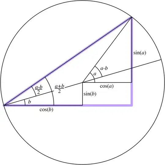

Proof Without Words
$$ \large\color{#8060A0}{\frac{\sin(a)+\sin(b)}{\cos(a)+\cos(b)}=\tan\left(\frac{a+b}2\right)} $$
