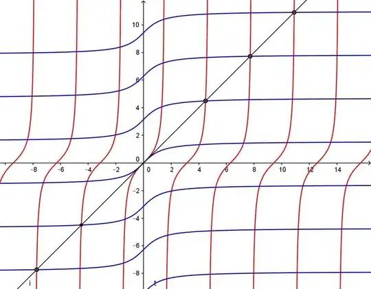

Setting $a=\dfrac{\pi}{x}$, we have to look for non-zero solutions $a_k \ (k \in \mathbb{Z^*})$ of equation $\tan(a)=a$. There are an infinity of them: see graphics below. As a consequence, the solutions of the initial problem are $x_k=\dfrac{\pi}{a_k}.$

(as can be understood by the graphical representation of $f_k$, which is the $k$th branch in blue on the graphics, resulting from a $k$ times "upper translation" from mother function $\tan^{-1}$).

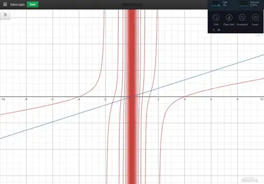

Looking at a graph, we have an infinite amount of interception points:
Indeed, the behavior of the $\tan$ around $x=0$ is not very good for most numerical methods.
