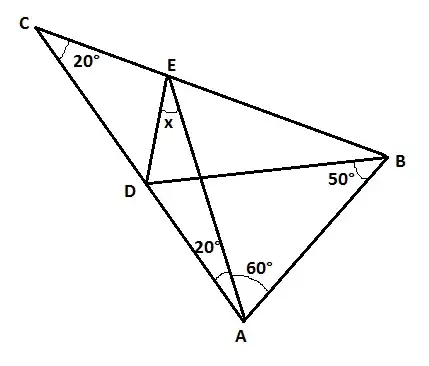

Knowing AC = BC, find x.

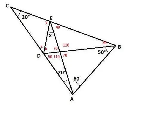

I tried to solve the question and found many angles.
And x + k = 110, x + y = 140, k + z = 130, z + y = 160.
But I still can't find x. Is this problem uniquely solvable?
The book answer is x = 30°.

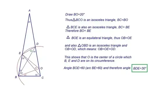

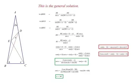

Yes this problem is solvable and there are distinct solutions.enter image description here

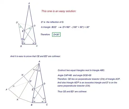

And this is pure geometric solution: enter image description here
And more easier solution is: enter image description here

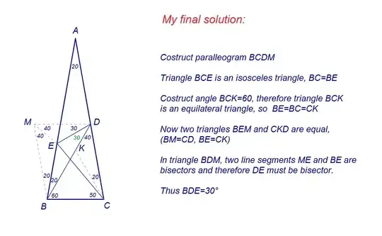

And my final solution: enter image description here
