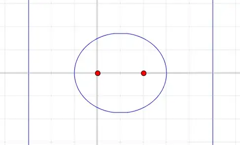

Let's do this step by step.
\begin{align*} \lvert PF\rvert &= e\,\lvert PL\rvert \\ \lvert PF\rvert^2 &= e^2\,\lvert PL\rvert^2 \\ x^2+y^2 &= \left(\tfrac12\right)^2(x+1)^2 \\ 4x^2+4y^2 &= x^2+2x+1 \\ 3x^2-2x+4y^2 &= 1 \\ 3\left(x^2-2x\cdot\tfrac13+\tfrac19\right) + 4y^2 &= 1+3\cdot\tfrac19 \\ 3\left(x-\tfrac13\right)^2 + 4y^2 &= \tfrac43 \\ \tfrac94\left(x-\tfrac13\right)^2 + 3y^2 &= 1 \\ \left(\frac{x-\tfrac13}{\tfrac23}\right)^2 + \left(\frac{y-0}{\sqrt{\tfrac13}}\right)^2 &= 1 \end{align*}
So the center would be at $(\tfrac13,0)$, the length of the semiaxis in $x$ direction would be $\tfrac23$ and the length of the semiaxis in $y$ direction would be $\sqrt{\tfrac13}$. The grid in the following illustration has distance $\tfrac13$ between the lines.
Figure of ellipse with coordinate axes, grid, foci and directrices
Note that the above computation heavily relies on the fact that the directrix is vertical, which makes the whole ellipse axis-aligned. Otherwise we'd have to account for rotation, which would complicate things. See this post of mine for reading geometric properties of a generic equation. In the case of a focus and directrix description, it would be easier to first transform coordinates to axis-align the directrix, though.
I'm not sure how you obtained your equation, so I can't tell you where you went wrong.
