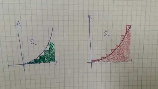

In page 5 Apostol explains to us in modern terms Archimedes's method of exhaustion applied to a parabola. He uses a method of 'approximating from below' and ' approximating from above'using rectangles. I thought I understood what they meant but I got confused when he says that the the area of the outer rectangles $S(outer) = b^3/n^3(1^2 + 2^2 + 3^2+....+n^2)$ while S(inner) = $ b^3/n^3(1^2 + 2^2 +...+ (n - 1)^2)$. Now why is it that the outer rectangles add up to $n^2$ while the inner rectangles stop 1 n less?
So it would be very nice if someone can explain to me the meaning of approximating from above and below and how to acquire the area of each separately.

This makes some sense right? Now what shapes should you choose for $S_-$ and $S_+$? Well, lets build a not-that-simple shape that is composed of super simple shapes: rectangles! We let $S_-$ be the shape whose area is in green in the image and we let $S_+$ be the shape whose area is in red in the image.
So imagine we want to measure the area $A$ in squares. We can see that $S_-$ is made up of several rectangles with width $1 sq$ and different heights. So total area of $S_-$ is $\sum {A}_{rect} = \sum width \times height_{rect} = width * \sum height_{rect}$. And in a similar fashion for $S_+$.
Now I will ask you to do the following: grab a piece of paper and mimic my drawing, but instead of using rectangles with width of 1 square, draw them with width $1/2$ square. Look at your drawings and try to understand that your $S_-$ will be bigger than mine, because the rectangles will be closer to the line of the parabola from below and that the area of your $S_+$ will be smaller than mine, for the same reason: the red rectangles are closer to the parabola line.
If you could draw rectangles with width infinitely small, both approximations would be very, very close and you would arrive at the formula that Archimedes arrived. The area below the parabola is $\frac{b^3}{3}$
Let's dig a bit more why that is. Imagine you want to calculate the area below the parabola that starts with $x=0$ and goes up until $x=b$. The best way you have to tell me what shapes $S$ you are using is telling me how many rectangles you have. Because we have the same value of $b$, that suffices. So let's say you create $n$ rectangles all of equal width. Therefore you are splitting the interval $[0, b]$ in $n$ parts, each of length $b/n$. Now make a graph and tick the $xx$ axis to accordingly split the interval in those parts. Do this for two graphs. One for $S_-$ and the other for $S_+$. Now connect each tick to the parabola with a vertical line. Because $S_-$ has area below the parabola, connect each vertical line to the one on the right, to create a rectangle below the parabola. For $S_+$, connect each vertical line with the one on the left creating a rectangle above the parabola. (Note that you have $n$ rectangles on both graphs. Notice that the ith rectangle spans from $x = \frac{(i-1)b}{n}$ to $x = \frac{ib}{n}$ and therefore the height of the ith rectangle is either $(\frac{(i-1)b}{n})^2$ or $(\frac{ib}{n})^2$ depending on the shape you are talking about.
