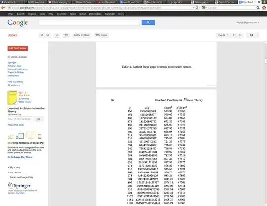

Here is a table from the third edition (2004) of Unsolved Problems in Number Theory by Richard K. Guy, in which $p = p_n$ is a prime but $n$ is not calculated, then $g = p_{n+1} - p_n,$ and $p = p(g),$ so $p_{n+1} = p + g.$
=-=-=-=-=-=-=-=-=-= enter image description here =-=-=-=-=-=-=-=-=-=
