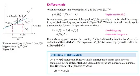

I am not aware of any textbook defining differentials like this. What kind of textbooks have you been reading? – Najib Idrissi
which textbooks? – m_t_
Check "Calculus and Analytic Geometry", "Thomas-Finney", 9th edition, page 251
and "Calculus: Early Transcendentals", "Stewart", 8th edition, page 254
They literally defined differential by another differential.
    That definition says "if you have the differential of $x$, then the differential of $f(x)$ is $f'(x) dx$". It doesn't really say what $dx$ is. For its own purposes it does not really need to do that, because for its purposes this is just notation, not really an object in its own right. One can make differentials into objects in their own right through either differential forms, hyperreal analysis, or smooth infinitesimal analysis. The latter are the two most prominent types of nonstandard analysis. These have been discussed at length on MSE, in the context of questions much like this one. – Ian Nov 03 '16 at 10:56

What book are you reading and where did you find such definition? Since you mentioned Stewart in your post, I would like to mention that the version he gave in his calculus book is not circular:
[Added later:] In Stewart's definition, he is using the differential of $x$ to define the differential of $y$, which is not circular because they are two different things in the definition: first of all you define $dx$ to be $\Delta x$, which is a real number and call it the "differential of $x$"; then you define "the differential of $y$ (at $x$)" be $f'(x)\ dx$ and denoted it as $dy$.
First of all we define differential as $\mathrm{d} f(x)=f'(x)\mathrm{d} x$ then we deceive ourselves that $\mathrm{d} x$ is nothing but another representation of $\Delta x$
No. It is the other way around in Stewart's definition. He defines $dx$ to be $\Delta x$ first.
and then without clarifying the reason, we indeed treat $\mathrm{d} x$ as the differential of the variable $x$
Again, it is the other way around. First $dx$ is defined, then it is called the differential of $x$.
