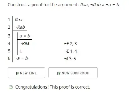

This answer is to only part of the question. It is similar to what Bram28 suggested although it places the steps in a proof checker:
If I have
  1. Raa
  2. ¬Rab
can I infer from both premises the line ¬(a=b) with the Id rules, or do I need some intermediate step? Or is it just wrong?
Here is a proof:
I can use the assumed equality on line 3 to make the substitution in line 2 which allows me to derive line 4. That leads to a contradiction (line 5) allowing me to negate the assumed equality.
