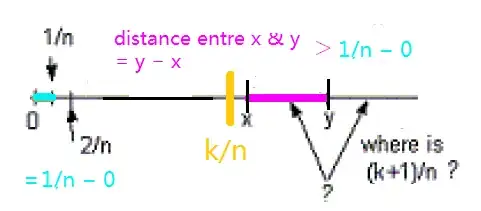

This PDF may help, but I improved the picture :
Whence we observe by inspection : $\color{#1FB4BF}{1/n} < \color{#E431D2}{(y - x)}$ for all $x, y \in \mathbb{R}$.
Separately from the line above, we also know $ \; k/n < x $.
Add both inequalities above: $ k/n + \color{#1FB4BF}{1/n}< x + \color{#E431D2}{(y - x)}$.
In summary, $k/n + \color{#1FB4BF}{1/n} = \dfrac{k+1}{n}$ $\in (x,y)$ is the rational number desired.
