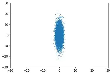

I'd just like to add a bit of visuals to the other answers.
When the variables are independent, i.e. the distrubtion is isotropic, it means that the distribution is aligned with the axis.
For example, for $\Sigma = \begin{pmatrix}1 & 0 \\ 0 & 30\end{pmatrix}$, you'd get something like this:
image of 2D gaussian with higher Y variance

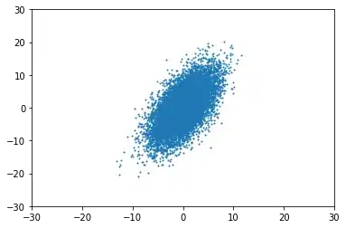

So, what happens when it is not isotropic? For example, when $\Sigma = \begin{pmatrix}1 & 15 \\ 15 & 30\end{pmatrix}$, the distribution appears "rotated", no longer aligned with the axes:
image of 2D gaussian with covariance between X and Y
Note that this is just an example, the $\Sigma$ above is invalid since it is not PSD.
Code:
import numpy as np
from matplotlib import pyplot as plt
pts = np.random.multivariate_normal([0, 0], [[1,15],[15,31]], size=10000, check_valid='warn')
plt.scatter(pts[:, 0], pts[:, 1], s=1)
plt.xlim((-30,30))
plt.ylim((-30,30))
    This seems to contradict the other answers, the matrix [1 0;0 30] is a diagonal matrix, but it can't be written as $\sigma I$ since not all diagonal entries are the same. I'm not sure which one it should be – Alex Li Sep 27 '20 at 20:34
    Isotropic means the same in all directions which the distribution in this example clearly is not. Aligned with the axes is not the same as isotropic in general, in fact it is only the same when the covariance matrix can be written as $\sigma I$ as other commenters have noted. – Epimetheus Sep 19 '21 at 20:00
    The example is incorrect. Isotropic means the probability density is equal (iso) in every direction (tropic). In gaussians this can be achieved with a $\sigma^2 I$ covariance matrix. – sfotiadis Jul 14 '22 at 07:46
    This answer is incorrect, the covariance matrix [1 0; 0 30] is not an isotropic Gaussian. You should edit/remove this as it's somehow accrued +16 points and could mislead people. – OrangeMan Nov 16 '22 at 17:02
