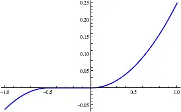

This is a classical example of non uniqueness due to the fact that the right hand side of the equation, $\sqrt{|y|}$, is not Lipschitz at $y=0$. You show this by direct computation. The equation is in separeted variables: $$ \frac{dy}{\sqrt{|y|}}=dt,\quad y(1/2)=1/16. $$ Integrating, and taking into account the absolute value, we see that $$ y(t)=\frac{t\,|t|}{4}=\begin{cases} t^2/4 & t\ge0,\\-t^2/4 & t<0, \end{cases} $$ is a solution. But for any $\tau\in(-1,0)$, the function $$ y_\tau(t)=\begin{cases} t^2/4 & t\ge0,\\0 & \tau<t<0\\-(t-\tau)^2/4 & t<\tau, \end{cases} $$ is also a solution. Below is the graph of $y_{-1/2}$.
Graph of $y_{-1/2}$
By the way, the set of solutions is not a vector space.
